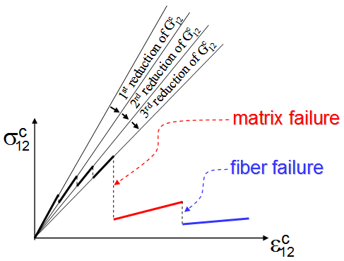

Within the region labeled Damage State 1 in Part A of the plot mentioned above, the Helius PFA pre-failure nonlinearity feature employs a four-segment, piecewise linear representation of the longitudinal shear response (i.e.,

vs.
and
vs.
) that occurs when the Helius PFA pre-failure nonlinearity feature is invoked. In this plot, prior to any matrix or fiber constituent failure, the composite average longitudinal shear moduli (
and
) undergo a series of three discrete reductions. The discrete reductions in
and
are produced entirely by consistent discrete reductions in the matrix average longitudinal shear moduli
and
while all other matrix and fiber constituent properties remain constant. This procedure is intended to simulate the gradual accumulation of sub-microcracks in the matrix that occurs prior to complete matrix shear failure.
Note, the implementation of this feature requires only six additional pieces of information (i.e., six constants) that identify the three fractional reductions imposed on
and
and the three levels of matrix average longitudinal shear stress (
and
) at which these reductions are imposed. Obviously, the determination of these constants requires a measured longitudinal shear stress/strain curve (e.g.,
vs.
