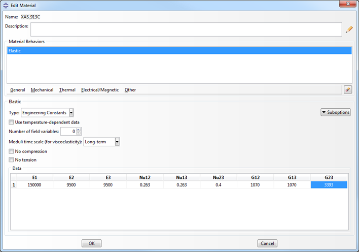

The material properties [1] for the linear elastic ply material are given below. This material is used to define the ply section, not the cohesive section.
E11 = 150 GPa
E22 = E33 = 9.5 GPa
v12 = v13 = 0.263
v23 (assumed) = 0.4
G12 = G13 = 1.07 GPa
G23 (assumed) = 3.393 GPa
  1. Using the Property module, create a new material (Material > Create) that is Elastic and of type Engineering Constants and enter the values from above in units of N-mm. Name the material XAS_913C. The completed Edit Material dialog box should appear as shown below.
