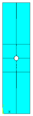

  9. Click Main Menu > Preprocessor > Modeling > Operate > Booleans > Subtract > Volumes.
  10. Select the 8 blocks that were created in Steps 4 and 5 and click OK. When prompted to select the volumes to be subtracted, pick the cylinder and click OK. The plate should appear as shown below.
  11. To complete the geometry, the 8 volumes must be merged. Click Main Menu > Preprocessor > Modeling > Operate > Booleans > Glue > Volumes. Select the 8 volumes and click OK.
