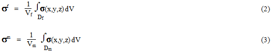

where V is the total volume of the RVE. Similarly, the fiber and matrix average stress states can be expressed as
where Vf and Vm are respectively the volumes of the fiber and matrix constituents within the RVE (V=Vf +Vm), and Df and Dm denote respectively the subdomains occupied by the fiber and matrix constituents within the RVE (D = Df
Dm). Combining Eqs. 1-3 yields
where φf = Vf/V and φm = Vm/V are volume fractions of the fiber and matrix constituent materials respectively.

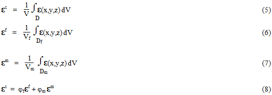

Similar reasoning can be applied to the strain tensor yielding Eqs. 5-8 below.
