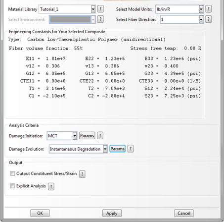

Select Plug-ins > Autodesk > Create Composite Material from the main toolbar. The Create Composite Material plug-in appears.
From the Material Library list, select the material you created in the previous section, Tutorial_1.
Note: The unit system dependent Engineering Constants specific to this material are listed in the dialog box for you to review.
Select lb/in/R from the Select Model Units list.
There are 4 unit systems to choose from. The default unit system is N/m/K.
Select 1 as the fiber direction.
2 can also be used as the fiber direction, but it would require a different composite layup orientation than the 1 direction. As a general rule, it is recommended that 1 be used as the fiber direction to maintain consistency from model to model. On occasion, however, it will not be possible to create an orientation in Abaqus that allows for the 1 direction to be the fiber direction due to the combination of complex model geometry and section orientation limitations. In such cases, it may be necessary to use the 2 direction as the fiber direction.
Accept the remaining default settings for the Analysis Criteria and Output options.
The dialog box should appear as shown below.
Click OK.
After completing these steps, a user material is created. This material is used to define the composite layup for the plate.
