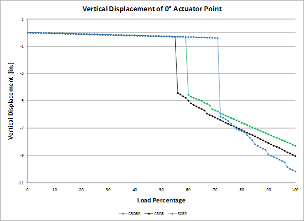

The table below displays the load level at which each type of failure event is predicted by the three models. The figure below displays the overall vertical load-displacement curves for the composite structure predicted by the three models.
Note:
  1. Load percentage is on a 0-100% scale
  2. Global failure is defined as a large discontinuity in the load-vertical displacement curve for the 0° application point of the load head shown previously

    Even though the SC8R element predicts initiation of localized constituent failure at a lower load level than the C3D8R element, the SC8R element predicts that global structural failure occurs at a higher load level (72%) than the C3D8R element (60%). The fact that the SC8R predicts a more gradual failure cascade process is due primarily to the fact that localized material failures do not affect the transverse stiffnesses (E33, G13, G23) in the SC8R element (Abaqus requires these stiffnesses to be constant in the SC8R element). Since the transverse stiffnesses do not experience any degradation, the SC8R elements can more easily accommodate load re-distribution without causing additional localized failures. To summarize, the C3D8R and SC8R elements exhibit very different failure cascade behavior.
