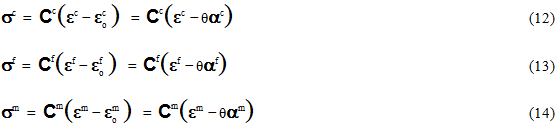

The first step in the development of the MCT decomposition is to invoke suitable constitutive relations that express average stress measures in terms of the corresponding average strain measures. We impose the restriction that constitutive relations be linear so the MCT decomposition remains unique and mathematically tractable. We will see later, the restriction to linear constitutive relations does not pose a serious limitation; the MCT decomposition can still be utilized in nonlinear problems. Equations 12-14 list the various volume-averaged, linearized constitutive relations that will be employed.
In Eqs. 12-14, Cc, Cf and Cm represent the 6x6 constitutive matrices (secant formulation) for the homogenized composite, the fiber constituent, and the matrix constituent materials respectively. θ represents a uniform temperature change of the composite material relative to the uniform reference temperature where material properties were measured. The terms αc, αf, and αm are 6x1 vectors that represent thermal coefficients of expansion for the homogenized composite, fiber constituent, and matrix constituent materials respectively. Since the constitutive relations are linear, the individual components of Cc, Cf, Cm, αc, αf, and αm are simply constants. However, to apply the MCT decomposition to nonlinear problems, it is assumed that the constitutive relations (Eqs. 12-14) are linearized about the current state (as defined by σc, εc, σf, εf, σm, εm and θ). This approach is entirely consistent with the approach commonly employed in nonlinear structural level analyses where an overall nonlinear response of a composite structure is represented by a sequence of piecewise linear responses.

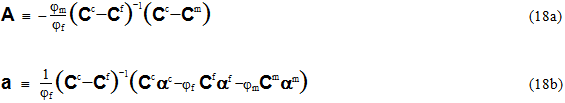

For convenience, let us now define a 6x6 matrix A and a 6x1 vector a as follows.
Using these newly defined quantities, Eq. 17 can be written simply as
Note that the matrix A relates the average mechanical strains in the constituents, while the vector a relates the average thermal strains in the constituents. Equation 19 can now be used to eliminate the average fiber strain εf from Eq. 8, yielding an expression for the matrix average strain state εm in terms of the composite average strain state εc.
