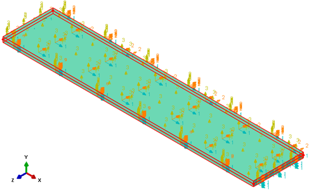

  4. To orient the plies and the cohesive section, a datum coordinate system must be created and assigned to the part.
  5. Create a datum coordinate system (Tools > Datum) using the 3 points method called Ply_Coord. Use the point 0, 0, 0 as the origin, 1, 0, 0 as the X-axis point, and 0, 0, -1 as the point in the X-Y plane.
  6. Assign the coordinate system to the whole part (Assign > Material Orientation). The orientation is shown below.
