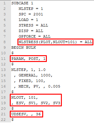

The example below demonstrates how to use the NLSTRESS, NLOUT, and UDSESV entries to request output of all nonlinear stresses and user state variables 1-3. To view these outputs in Patran you must also use the PARAM entry.
Note: This example is intended to demonstrate the entries required to obtain output of certain variables for post-processing. Therefore, some necessary entries are omitted.
