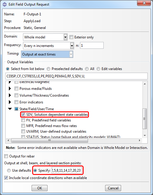

By default, the MCT state variables are not automatically written to the output database file (*.odb file) and must be explicitly requested. You can request output of MCT state variables in the Edit Field Output Request dialog box, which is accessed from the Step module by clicking Output > Field Output Requests > Edit > "Name of output request" in the main toolbar. To request MCT state variable output, select the box labeled "SDV, Solution Dependent State Variables" from the scroll-bar list of output variables shown below.
Also by default, field variables (including the MCT state variables) are only output at the top and bottom section points of each layered element. To view the field variables within each material ply, specify additional section points by entering their values in the text box highlighted below. As an example, consider a flat composite plate with 4 plies and 3 section points per ply, for a total of 12 section points as shown in the Request Output of the MCT State Variables section. If the default section point values are used, only results for points 1 and 12 will available for viewing. You will not have access to the results for the interior material plies. However, if output is requested for each section point, the complete solution results can be viewed for each ply.
