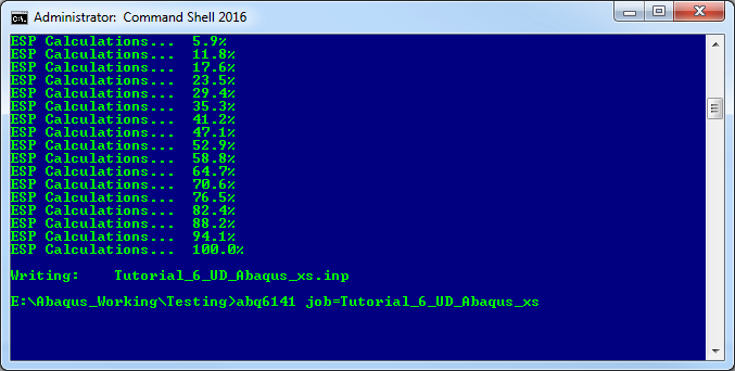

  2. Return to the Command Shell and type the following to submit the analysis, in this case with Abaqus 6.14-1
    >>abq6141 job=Tutorial_6_UD_Abaqus_xs
