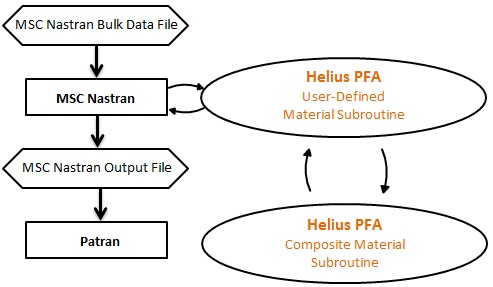

The image below shows a schematic of the individual components of the Helius PFA software and their interaction with the MSC Nastran software components. Block shapes indicate components of MSC Nastran, while ovals indicate individual components of the Helius PFA software. The User-Defined Material Subroutine (see image below) calculates constitutive relations and computes stresses for the MSC Nastran SOL 400 finite element code. The User-Defined Material Subroutine contains all the MCT constitutive relations for the individual constituents (fiber and matrix) and the homogenized composite material. In addition, the User-Defined Material Subroutine contains the constituent-based failure criteria and the nonlinear constituent damage algorithms. These degrade the stiffness of the constituents and the homogenized composite material to reflect the current damage state of the composite. The MSC Nastran SOL 400 finite element code calls the User-Defined Material Subroutine at each Gaussian integration point in the model where constitutive relations or stresses are requested.
In the image below, the Composite Material Library stores all of the material coefficients needed to completely define the MCT multiscale material model. Before a particular composite material can be used in a Helius PFA-enhanced finite element model, it must undergo MCT material characterization, and a unique material file must be added to the Composite Material Library. As shown below, the User-Defined Material Subroutine opens and reads the Composite Material Library to extract the necessary material coefficients for any composite materials used in the model. Note that material libraries are not necessary for Helius PFA cohesive materials. Since the number of inputs required to define a cohesive material are much less than a composite, the entire material is defined within the bulk data file.
