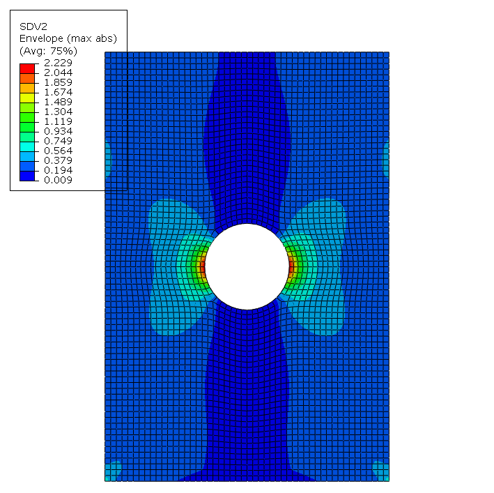

To view the maximum matrix failure index in all of the plies, envelope plots can be used. Envelope plots display the maximum or minimum integration point value across all of the section points in each element.
  1. To create an envelope plot, select Result > Section Points from the main toolbar. Select the Envelope option from the Categories box and click Apply. The plot should be similar to that shown below.
    The maximum matrix failure index is 2.226, which indicates that matrix failure is predicted to occur in one or more of the plies.

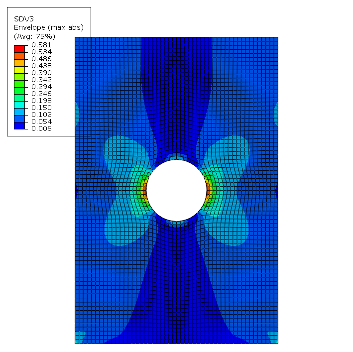

  6. From the main toolbar, select Result > Field Output and plot SDV3. SDV3 represents the fiber failure index and is an indication of how close the fiber is to failure. Fiber failure occurs when the value of SDV3 is greater than or equal to 1. The plot should be similar to that shown below.
Since the maximum value of SDV3 in all plies is less than 1, fiber failure is not predicted.
