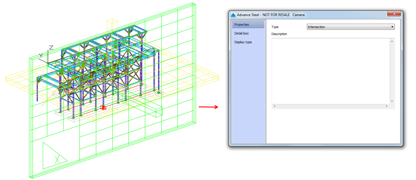

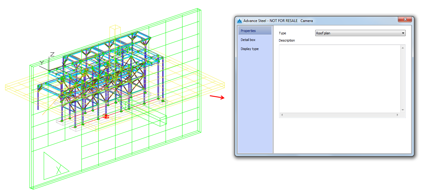

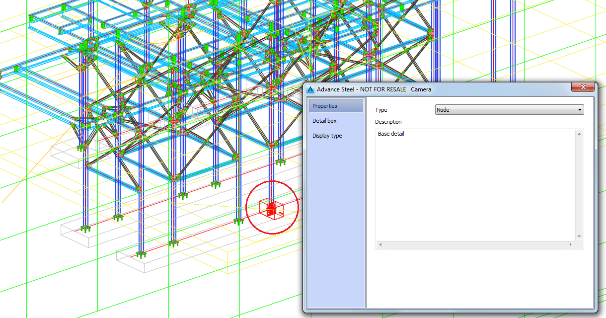

In this example, there are three cameras, each with different properties, set in the
Camera dialog,
Properties tab,
Type field:

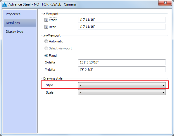

Also, none of them has any drawing style set in the
Detail box tab,
Drawing style section,
Style field:

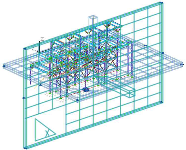

- In the model, select all the cameras.

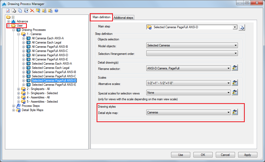

- In the
Drawing Process Manager window, go to
User >
Drawing Processes >
Cameras >
Selected Cameras PageFull ANSI-D. In the
Main definition tab >
Drawing styles section, select
Cameras from the drop-down menu.
- Click the

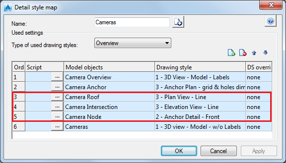

(Properties) icon on the right of the drop-down menu to see the
Detail style map of the current drawing process.

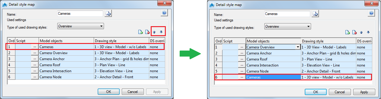

- Select
Cameras entry in the
Detail style map dialog and move it to the bottom of the list, using the arrows in the top right part of the list:
The drawing styles for cameras used in this process for:
Camera Intersection is
Elevation View - Line.
Camera Roof is
Plan view - Line.
Camera Node is
Anchor Detail - Front.

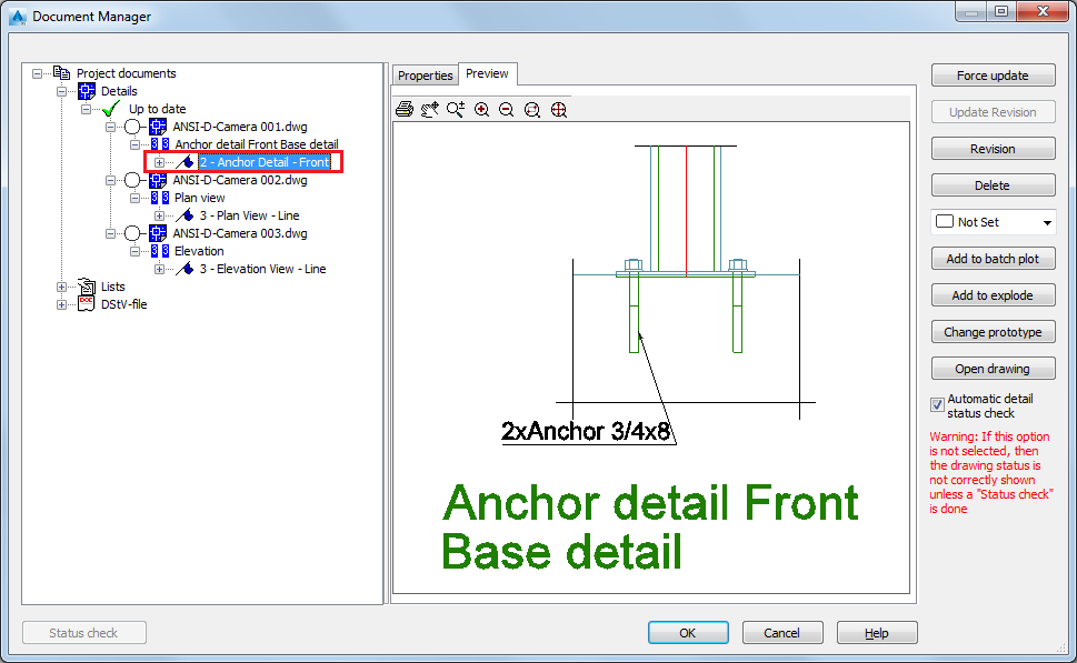

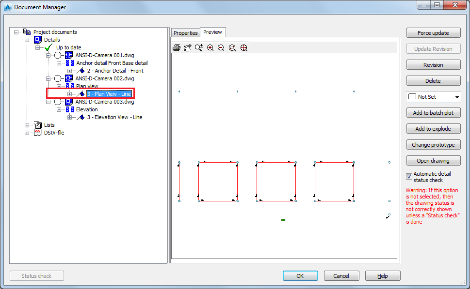

- Open the
(Document Manager), from the
Output tab.
- In the
Document Manager window, you can see the created detail drawings.
Your camera details are created using the drawing style set in the process detail map, for each type of camera:
