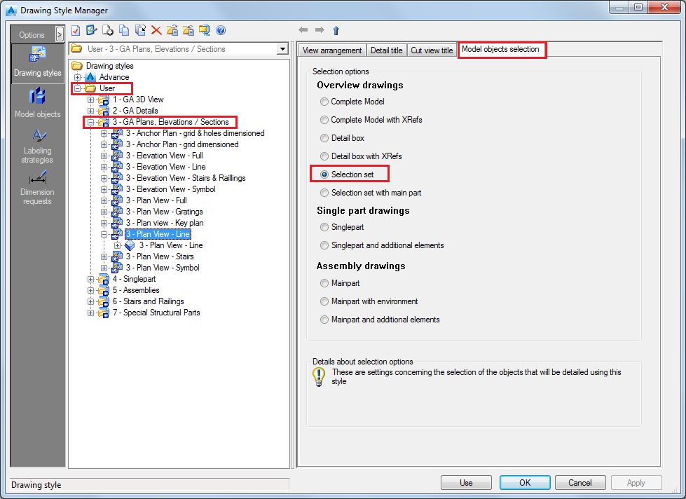

You can create a view, using a drawing style from either the Drawing Styles Palette or from the Drawing Style manager.
- Access the
Drawing Style Manager from the
Output tab >
Document Manager panel.
- Go to
User >
GA - Plans, Elevations/Sections >
Plan View - Line.
- In the
Model objects selection tab, under
Overview Drawings, choose Selection set and click
Apply.
- Click
Use in the
Drawing Style Manager window.

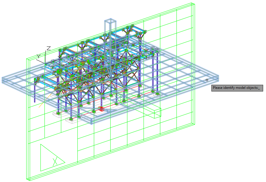

- Click
OK in the
Drawing type dialog.

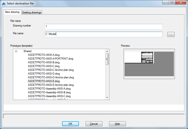

- Select the camera and click OK in the
Select destination file dialog.

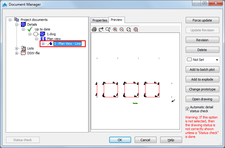

- Go to the
(Document Manager), from the
Output tab.
- Open the created detail drawing.
Notice that the drawing style used for creating the drawing is the one chosen in the Drawing Style Manager.
