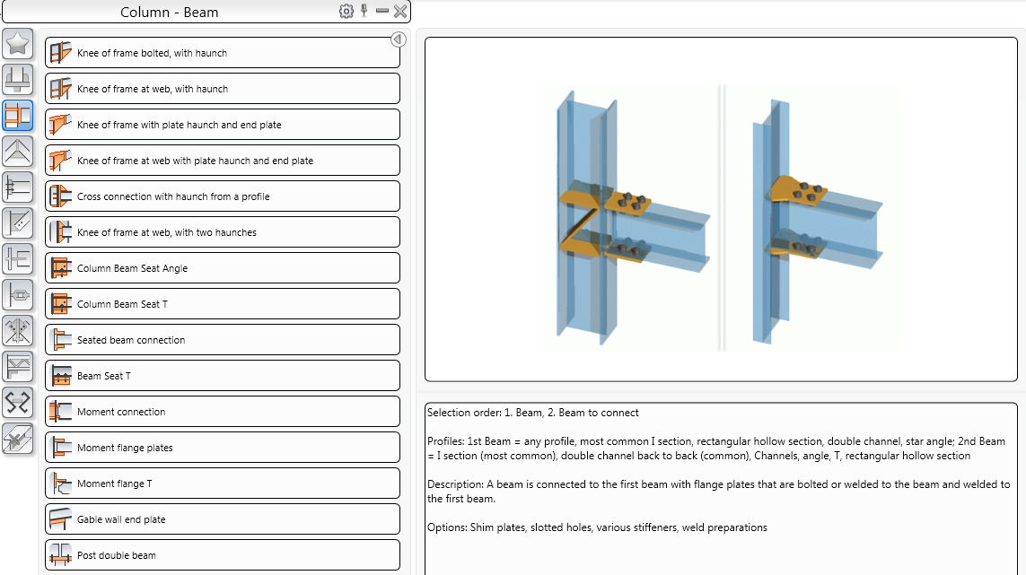

Advance Steel Joints are intelligent connections that consist of basic elements and dependent elements controlled by construction rules.
All individual joint elements, including their properties, are held together and represented as a gray box connection object.
A structural element creates several Advance Steel objects at a time. You can create entire structures by simply clicking one button.
All parts of a structural element relate to each other and properties such as their height, position, and section are changed in one step.
Click Home tab Extended Modeling panel (Connection Vault). Select from the categories of joints in The Connection Vault. Individual element types display appropriate joints.
Group frequently used joints in the Favorites category for quicker access.
