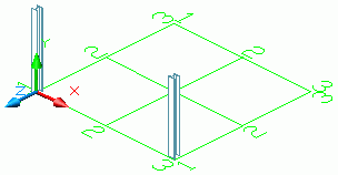

Example: Create straight beams HEA 200 x 2500 mm long
Click a suitable UCS. Refer to the above figure as an example.
On the ribbon, select
Home
Objects
Objects
Beams
Select a starting point at 0,0,0.
Move the mouse pointer in the Y-direction (the setting ORTHO causes an exact orientation entry) and enter
2500

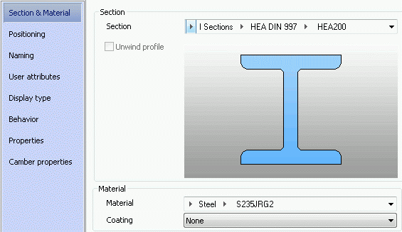

The
Beam
dialog appears. Select the section class (HEA), followed by the section (HEA 200).
