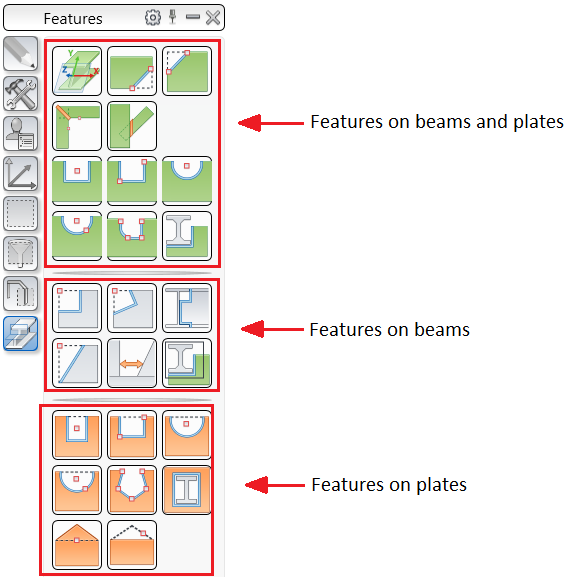

You can cut any beam or plate contour with the Advance Steel processing.
To cut or cope contours, use the tools located on the Features tool palette
Processings are displayed as green contours in the model. These features are Advance Steel Objects and cannot exist independent of an element.
