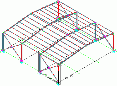

Example: Create purlins on the selected rafters
  1. On the ribbon, click (Purlins).
    • Home Extended Modeling (Purlins)
    • Extended Modeling Structural Elements (Purlins)
  2. Select the rafters and right click.
  3. To select a column for the eaves beam type 1 and press Enter.
  4. Select a column and right click.
The properties dialog box appears where the purlin layout can be modified.
