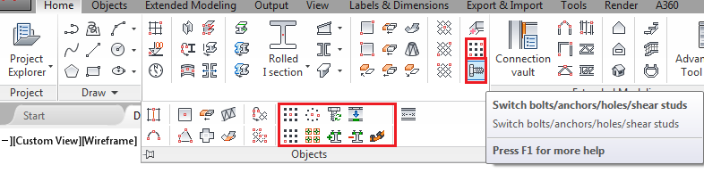

You create bolt patterns, anchor patterns, hole patterns and shear studs with the same commands that are grouped on the Objects tab Objects tab
Connection objects panel. The icon on the Switch panel indicates the active type of elements.
The most used bolt creation tools are on the Home tab
Objects panel.
