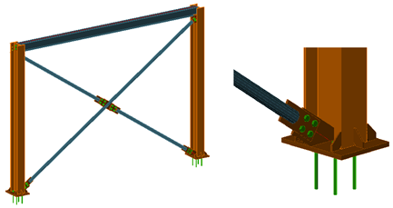

Example: Create a bracing
  1. Set the UCS perpendicular on the plane where the bracing needs to be created.
  2. Click Extended Modeling tab Structural Elements (Bracing).
  3. Enter the start point corresponding to the bottom end of the first column.
  4. Enter the end point of the ascending diagonal at the top end of the second column. Zoom in to make sure the correct points are selected using the snap NODE.
    The bracing is created and can be modified in the dialog.
  5. On the Connection Vault in the Tube Connections category, select
  6. Select the three objects to connect: the column, base plate and bracing tube beam.
    The connection is created and can be modified in the dialog.
