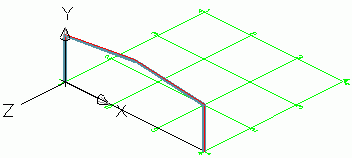

Example: Create a symmetrical portal frame
  1. Set a suitable user coordinate system.
  2. On the ribbon, click .
    • Home Extended Modeling
    • Extended Modeling Structural Elements
  3. Define the first base point.
  4. Define the second point.
  5. Define the height of the frame with a right click.
The frame is created and the properties dialog appears. Modify the frame size to suit specific requirements.
