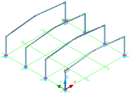

- On the Tools tool palette, click
(Copy).
- Select the entire frame and right click.
- Select the base point of displacement.
- Select the target point of displacement.
The frame is completely copied with all properties and connections using just two points.
