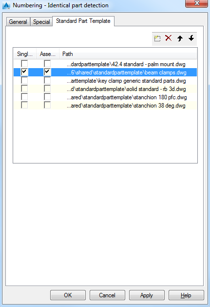

Standard Part Template tab
This tab lists the standard part models linked to the current project. The folder ..\ProgramData\Autodesk\Advance Steel\2016\Shared\StandardPartTemplate\ contains the standard part models. Each standard part template can be used for the single part, assembly detection or both.
Button
Function
Adds a new standard part template
Deletes the selected standard part templates
Moves up the list
Moves down the list
