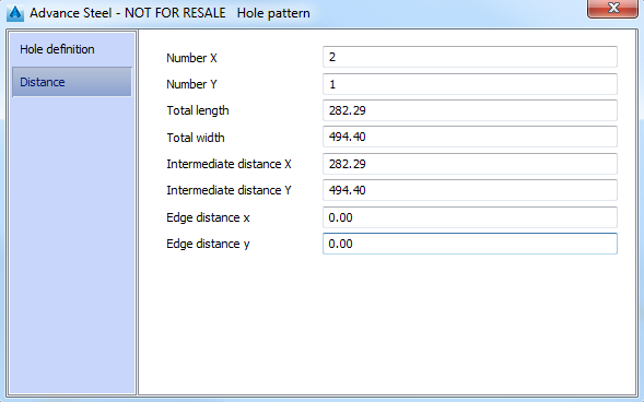

On this tab of the properties dialog box, you can modify the size of the hole group defined by two diagonal points.
Number X
Defines the number of holes in the X direction
Number Y
Defines the number of holes in the Y direction.
Total length
Defines the length of the hole pattern (in the X direction).
Total width
Defines the width of the hole pattern (in the Y direction).
Intermediate distance X
Defines the distance between holes along the X-axis.
Intermediate distance Y
Defines the distance between holes along the Y-axis.
Edge distance X
Defines the outer hole line distance to the hole pattern edge in the X direction.
Edge distance Y
Defines the outer hole line distance to the hole pattern edge in the Y direction.

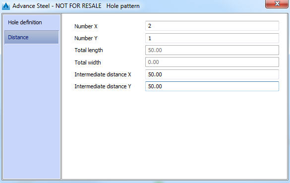

For a rectangular pattern created by a center point you can change the number of holes and the distance between the holes (changes are made relative to the pattern center point). The hole position within the group changes relative to the center point.
Number X
Defines the number of holes in the X direction.
Number Y

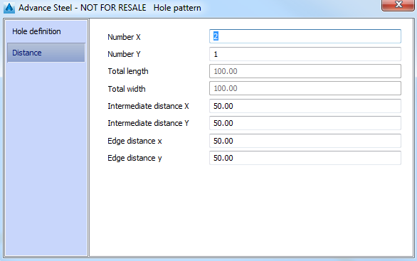

On this tab of the properties dialog box, you can modify the size of the hole group defined by a corner point.
The hole position within the group changes relatively to the corner point.
Number X
Number Y
Edge distance X
Edge distance Y
