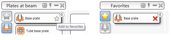

Bookmark frequently used connections
The Connection Vault provides a solution to finding connections that you need to access quickly on a regular basis. The selection bar includes a special category named Favorites. The Favorites category can contain shortcuts to connections from different categories.
When moving the cursor over a connection and selecting Add to favorites, a shortcut to that connection is added to the Favorites category.
The connections can be deleted from the Favorites category.
The connection does not move from its original category.
