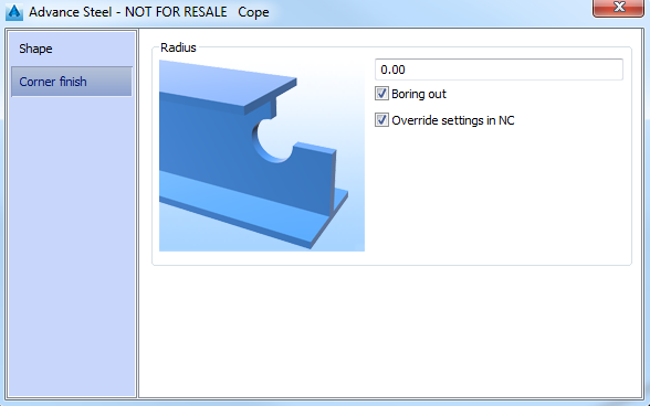

You can use the parameters on this tab to modify the cope shape.
Radius
Defines the radius at the cope corner.
Boring out
If selected, creates the following cope shape:
Override settings in NC
The NC can override the cope settings only when the cope type is straight.
