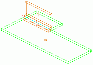

There are two methods to create folded plates:
With position adjustment
Two selected plates are aligned with a defined angle. The first selected plate is the main plate and the second selected plate is joined (moved) to the first one. The plates are realigned using the entered angle.
To access the command
Ribbon: Objects > Plates:
Command line: _AstorFoldedPlateExtend
To create a folded plate

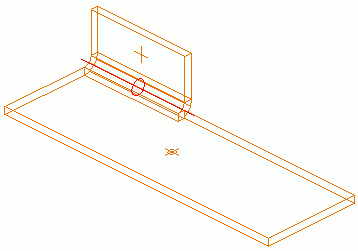

. Without position adjustment
Two plates are stretched or shortened along a line and joined. This method keeps the angle between the two plates.
Command line: _AstM4FoldedPlateConnect
