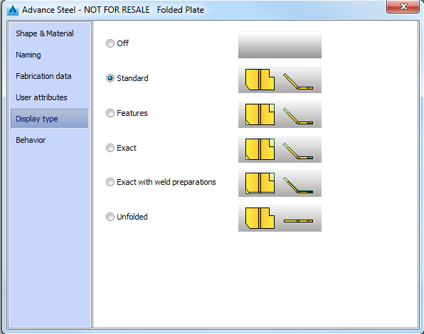

On this tab of the properties dialog box, you can select the folded plate display type.
Five display types are available:
Display type |
Folded plate |
Description |
Off |
Hides the plate |
Standard |
Plate contour without processing |
Features |
Plate contour with processing |
Exact |
Plate contour with processing and hole patterns |
Exact with weld preparations |
Same as Exact, with weld preparations |
Unfolded |
Displays the unfolded plates |
