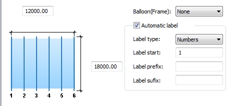

Total tab
On this tab of the properties dialog box, you can modify the group size and the labeling.
The top field defines the distance between the first and the last axis of the group. The number of axes changes accordingly. The other field defines the length of an axis.
The labeling text can be displayed with or without frames.
| None | Edging |
Automatic labeling
The axes can be labeled automatically or manually. If the automatic labeling is switched off, the labeling for each single axis can be changed on the Single axis tab . For the automatic labeling the following parameters can be set:
Controls the labeling type. The axes can be labeled with numbers, small letters or capital letters.
Defines the starting value for the automatic labeling.
Defines the constant prefix for the automatic labeling.
Defines the constant suffix for the automatic labeling.
Example:
Automatic labeling with numbers and prefix A0

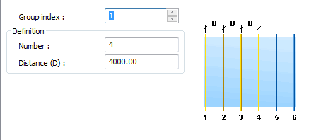

Group tab
On this tab of the properties dialog box, you can modify the group definition properties.
Selects the group to modify. The selected group is highlighted in red
Definition
Controls the number of axes in the selected group and the distance between them.
Defines the number of axes in the selected group.
Defines the distance between the axes of the selected group.

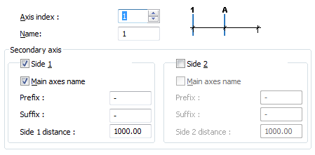

Secondary axis
You can add a secondary axis to the right or to the left of a main axis and choose a label using the main axis name with a suffix and a prefix.
These check boxes allow selecting the side where to add the secondary axis.
The axis is labeled using the main axis name.
Defines a constant prefix for the secondary axis labeling.
Defines the distance to the main axis.

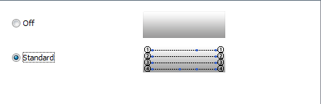

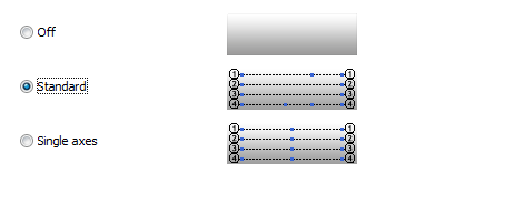

Display type tab
On this tab of the properties dialog box, you can modify the representation.
Off |
Hides the grid |
Standard |
Only the first and the last axis of the group have grips: end points and center point. With the grip in the center the group length can be modified, with the grips at the end the axis length (group width) can be modified. The last axis has an additional grip for moving the axis.
Single axis |
Each axis has three grips: end points and center point. The grip in the center allows moving the axis, the end grips allow modifying the axis length.

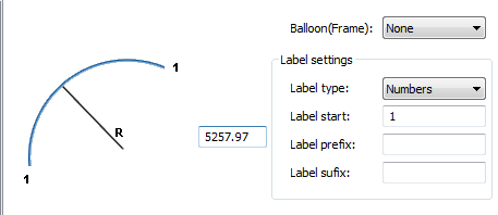

Curved tab
On this tab of the properties dialog box, you can modify the curved axis size and the labeling.
The field defines the curved axis radius.
Label settings
You can label the curved axis automatically using numbers, small or capital letters. The following parameters can be set:
