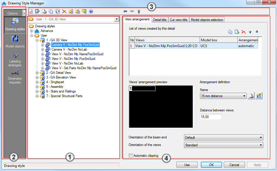

The Drawing Style Manager user interface reflects the structure of a drawing style.
- Tree panel
- Component panel
- Toolbar
- Properties panel

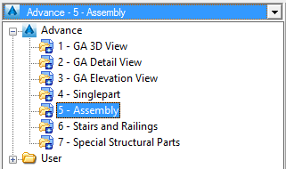

By clicking sign, the tree branch expands. The drawing styles in the tree are separated into two main categories:
  • Advance - This category includes all the drawing styles available in Advance. Their properties cannot be modified. If additional country settings are installed, a category will be created for each country setting.
  • User - This category includes a copy of all the drawing styles from the Advance category that can be modified at any level.

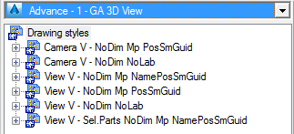

The drawing styles are grouped in categories (Camera, columns, etc.).
A category is selected using the drop-down list above the tree panel. The tree panel displays all the drawing styles in the selected category.

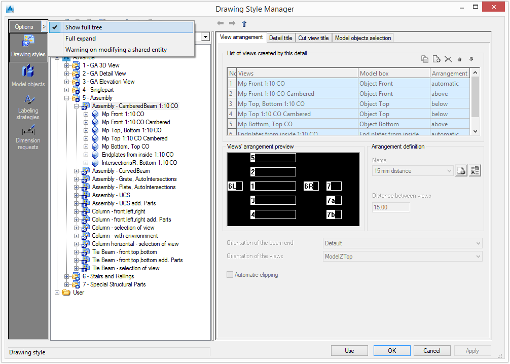

To view the entire tree, select the option Show full tree from the Options menu.

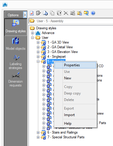

A context menu provides quick access to the management functions available for the selected element (drawing style, view, model object, etc.).
Figure 7: Drawing Style Manager - Context menu

When an item is selected on the tree panel, the item's properties are displayed in the properties panel.
To modify the column width, drag the boundary on the right side of the column until the column is the desired width.
