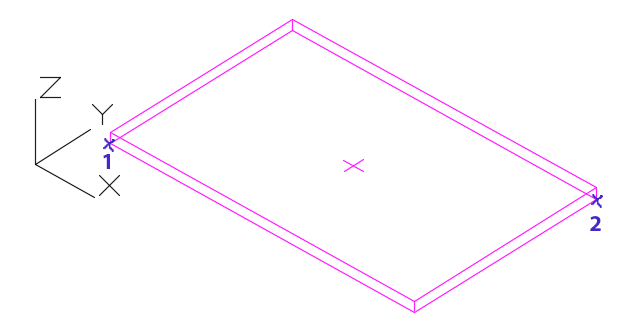

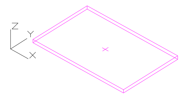

The rectangular plates of a default size are placed in the X/Y plane of the current coordinate system. The plate thickness direction is in the positive Z direction. You can control the Advance default plate thickness from the Management Tools.
To access the command
Ribbon: Objects > Plates:
Command line: _AstM4CreateRect1DigPlate
To create a rectangular plate using a center point
. The rectangular plates are placed in the X/Y plane of the current coordinate system. The plate thickness direction is in the positive Z direction. You can control the Advance default plate thickness from the Management Tools.
Command line: _AstM4CreateRect2DigPlate
To create a rectangular plate using two diagonal points
. Without a UCS in the right plane, you can create a rectangular plate by selecting three points. The three points define the creation plane.
Command line: _AstM4CreateRect3DigPlate
To create a rectangular plate using three points
