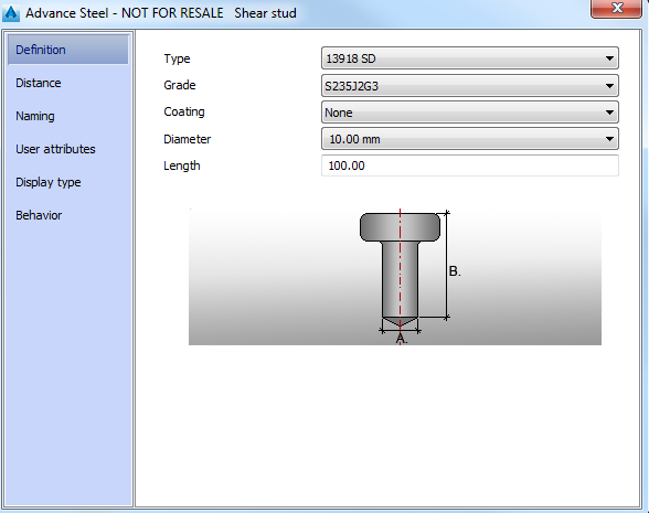

All shear studs have default properties that you can change in the properties dialog box, which automatically opens after you create a shear stud pattern.
Definition tab
Type
Select the stud shear standard from the list.
Grade
Select the steel grade from the list.
Coating
Select the coating from the list.
Diameter
Select the stud shear diameter from the list.
Length
Defines the length of the stud shears.

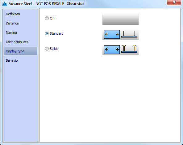

Display type tab
On this tab of the properties dialog box, you can select the stud shear display type.
Display type
Stud shears
Standard
Solids
