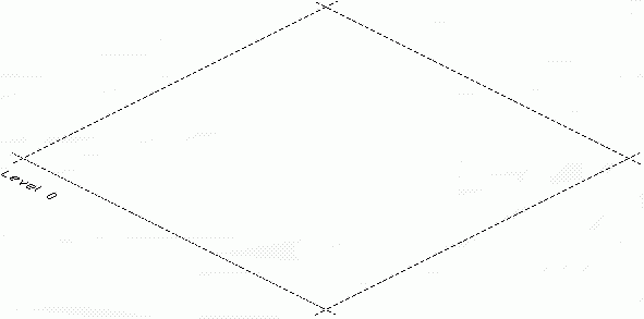

When visible in 3D, workplanes are represented by rectangles with a name. The size of the rectangle depends on the current zoom. Displaying the workplane helps understanding the active workplane in a 3D view and it is useful for viewing the workplane location when attaching elements.
