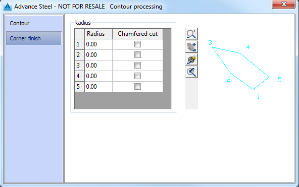

You can use the table parameters to change the shape of each corner of the polygonal contour.
Radius
Defines the radius of the corner finish.
Chamfered cut
If enabled, creates a chamfered corner. Otherwise a filleted corner is created.
Preview area
Displays a preview of the polygonal contour.
Zoom real time |
The cursor changes to |
Panoramic |
Moves the object in the preview area. |
3D orbit |
Modifies the 3D objects view in the preview area. |
Initial view |
Restores the initial magnification and position |
