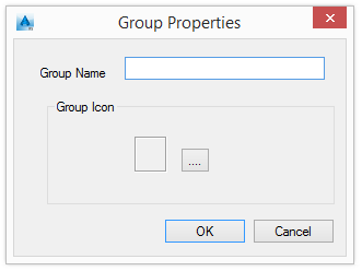

Create a new group
  1. Click New .
  2. Enter the name for the group.
  3. Click .
  4. Select the .bmp file that contains the icon for the new group.
Modify group properties
  1. Select a group.
  2. Click Properties .
  3. Change the name of the group.
  4. Click .
  5. Select the .bmp file that contains the new icon for the selected group

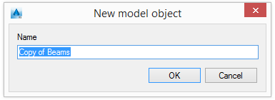

Copy a model object
  1. Click Copy .
  2. Enter the name for the new model object.
    The new model object can be moved to another group.
Note: The associated sub-styles are not copied with the model object.
Deep copy a model object
The deep copy function copies the selected model object and all associated sub-styles. The new model object can then be modified at any level, without changing the original.
  1. Select the model object to use as template.
  2. Click Deep copy .
  3. Enter the name for the model object.
