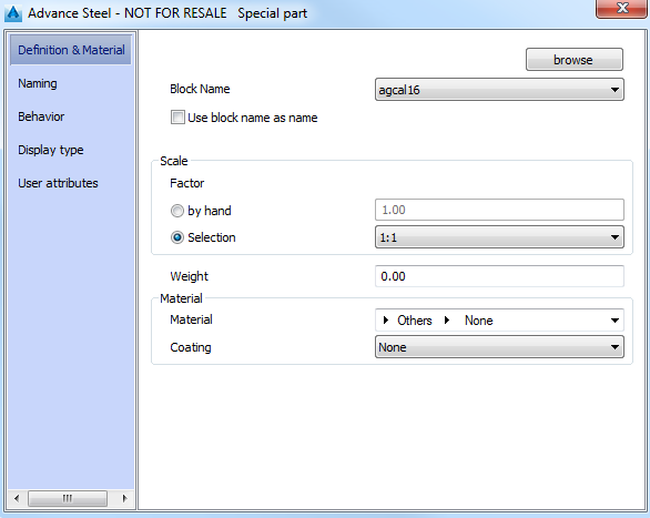

On this tab of the properties dialog box you can define the weight, the material and the insertion scale factor.
Browse
Displays a standard file selection dialog box in which you can select the special part DWG file.
Block name
Select the name of the special part DWG file.
Use block name as name
The block name appears on the Naming tab, in the Free remark field.
