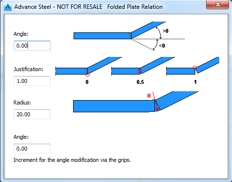

The options on this tab of the properties dialog box allow you to set the bending properties.
Angle
Defines the angle between the second plate and the plane of the first plate.
Justification
Defines the position of the bending center. There are three possibilities:
Value |
Result |
0 |
0.5 |
1 |
Radius
Defines the bending radius.
Angle
Defines the increment (grid jump) when modifying the angle between the two joined plates using the grip points.
