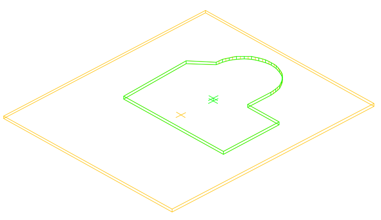

With this tool, you can cut all (polygonal) contours from a plate. They can be attached as inner contours as well as outer contours. The processing is defined by entering several points.

- Select a plate to process.
- Select the first point of the contour.
- Select the contour corner points one after another.
- Press <Enter> to finish or enter C (Close) to close the contour.
- The polygonal contour is created.
