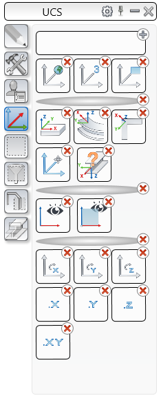

Reorganize existing tool palettes
You can group commands on the tool palettes for easier access to the frequently used tools.
The icons displayed in the tool palette can be reorganized with a long right-click on the palette which provides access to the customization.
The following manipulations are possible:
- Click on the top-right red cross to delete the icon.
- Drag & drop an icon in same or different group.
You can customize any existing or newly created Tool Palette to suit your needs:
- Rearrange the tools by dragging.
- Add separator lines.
- Add a new button to a tool palette.
- Delete buttons that you no longer need.
- Create a new tool palette.
- Create a new group of commands in a tool palette.
- Combine multiple commands in one button.
To exit customization mode, click the palette title bar.

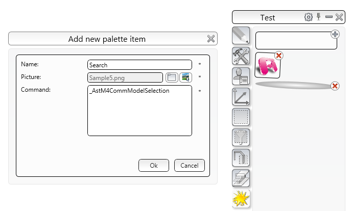

Adding a command to the tool palette
- Select the tool palette to modify.
- Long right click on any button on the selected tool palette. The tool palette switches to the customization mode.
- Click
and select
Command
from the menu.
- In the dialog box, make the necessary settings:
- Enter a name for the command. The Name appears as a tool tip when you hover over the button.
- Add a picture: Click Browse and select the desired image (.png file).
- In the Command field, enter the name of the command. You can combine multiple commands in one button.

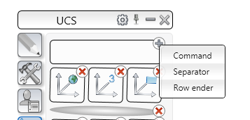

Adding a separator line to a tool palette
- Long right click on any button on the selected tool palette. The tool palette switches to customization mode.
- Click
and select
Separator
from the menu.
- If necessary, drag the separator to the appropriate location on the tool palette.

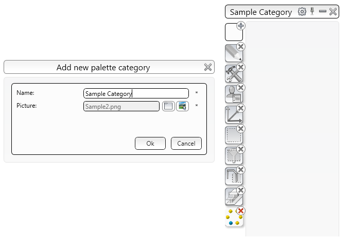

Adding a category to the tool palette
- Long right click on any button on the left side of the tool palette. The tool palette switches to customization mode.
- Click
and select
Category
from the menu.
- Enter a name for the category. The Name appears as a tool tip when you hover over the button.
