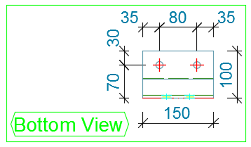

Toggle the display of green frames around details
Enables or disables the display of the green frames around the details.
To access the command
Ribbon: Labels & Dimensions > Parametric Views:
Command line: _AstM4CommDetSwitchHighlightState
