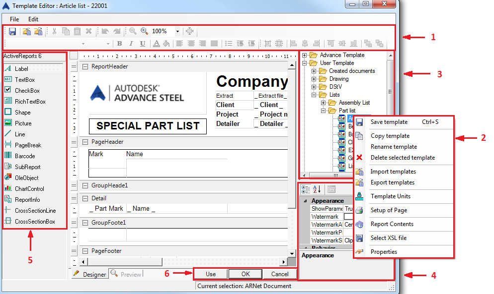

The BOM editor window opens.
The BOM Editor window
  1. Tools for template customization
  2. Tools for template management
  3. Template tree
  4. Properties list
  5. List of controls
  6. Buttons for applying or canceling modifications
Template designer
Template preview
Different tools for template management are available in the context menu of a selected template.

Template tree
The predefined templates for material reports is displayed in the right panel of the BOM Editor window. The tree is divided in three groups of templates.
Advance Template
Includes all BOM templates from Advance. Their properties cannot be modified.
User Template
Includes a copy of all BOM templates from Advance. Their properties can be modified.
Project Template
This group can be used to copy templates for project specific modifications.
Each group contains the following categories:

Properties list
Displays the current settings for properties of the selected object in the Design area. You can modify any property that can be changed by specifying a new value.
The properties are grouped in several categories.

Buttons for applying or canceling the modifications
Use
Applies the selected template. The BOM Editor closes and the list creation begins.
OK
Saves any modifications and exit the BOM Editor.
Cancel
Closes the BOM Editor without saving any modifications.
