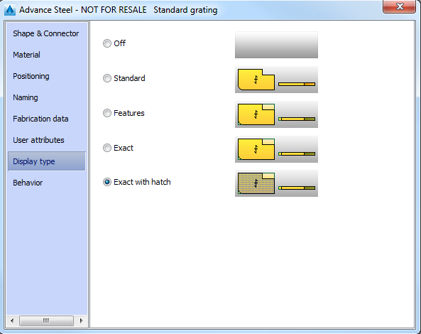

On this tab of the properties dialog box, you can modify the grating position relative to the insertion point and the thickness direction.
| Display type | Grating | Description |
| Off | Fades off the grating | |
| Standard |
Grating contour without processings |
| Features |
Grating contour with processing and holes patterns |
| Exact |
Grating with the exact contour, with processing and hole patterns |
| Exact with hatch |
Grating with the associated hatch on the top side. The hatch takes into account the openings in the grating. |
