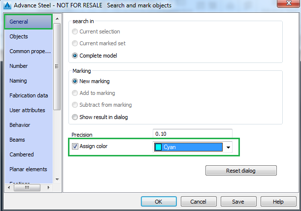

In order to use the "Marking by colors" feature in a project, you need to access the Search and mark objects dialog. You can do this in two ways:The Search and mark objects dialog appears. In the General tab check Assign color and from the drop down menu select your desired color to mark the query.

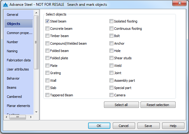

In the Objects tab select the type or types of objects you want to be displayed with that color.

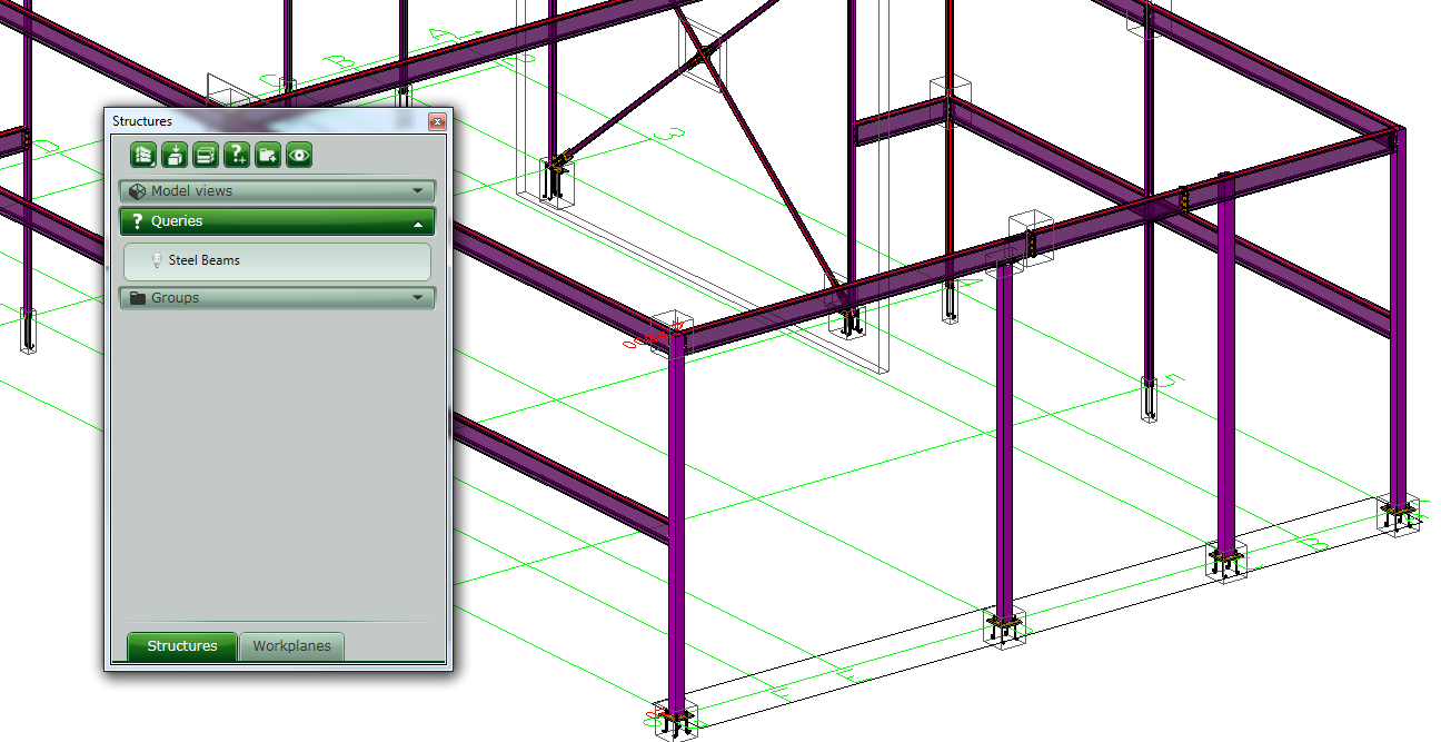

After you set the query parameters and validate all the changes, the searched objects are marked with the assigned color.
