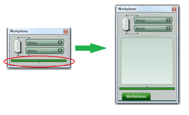

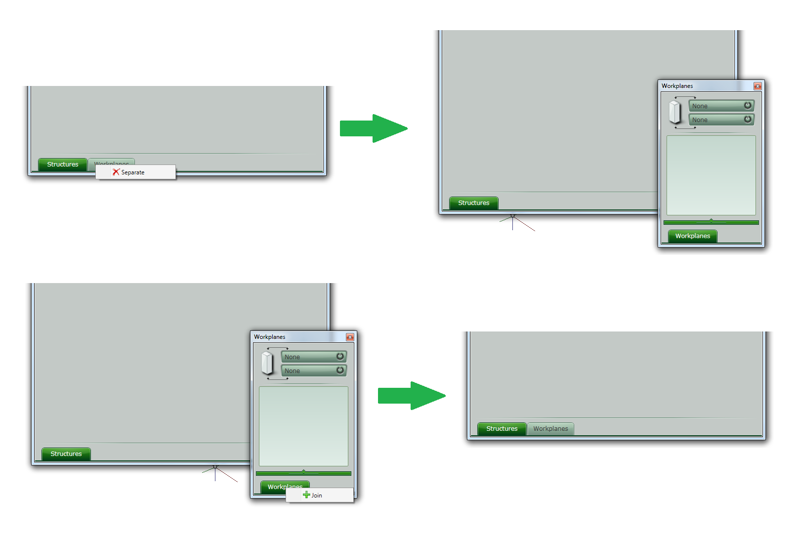

The two panes of the Project Explorer (Structures and Workplanes) can be displayed separately and joined back together by right clicking on either of the panes and selecting Separate or Join.
If separate, the Workplane pane can be collapsed by clicking the lower bar.
