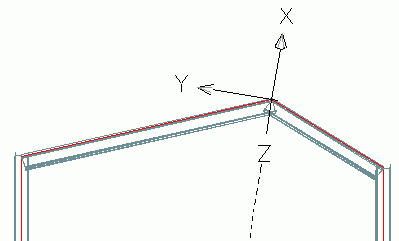

This tool creates a user coordinate system at a bisecting line. It is suitable for creating sections at the bisecting angle of two other beams (e.g. in facade construction).
