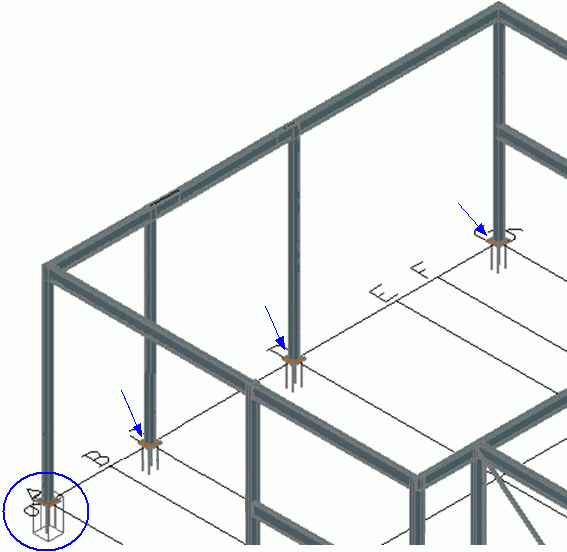

Example:
For the four columns in the picture, base plates have been created using the same macro (). The created joints are independent and their properties have been modified separately. You can transfer the properties from one joint (A6) to the other three and get identical base plate connections.
