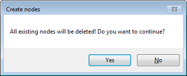

When using this command, existing nodes will be deleted and new ones will be created. The application warns you about this with the following message:
If you choose "Yes", the analytical nodes will be created at each beam end.

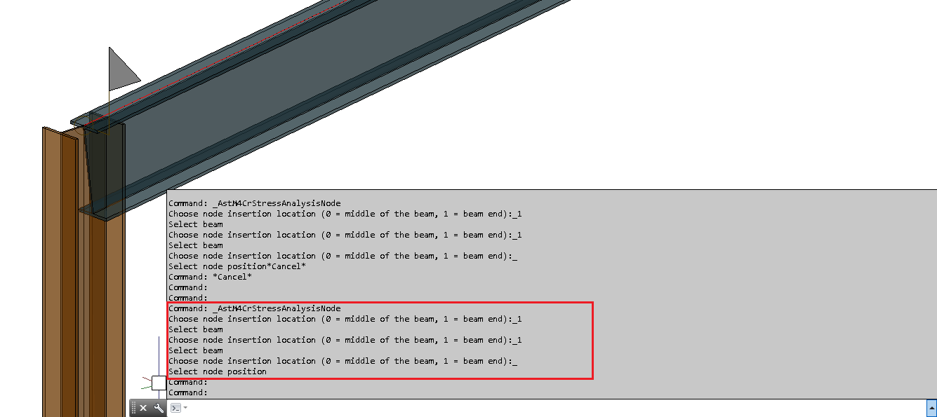

In the following image shows what the command bar (platform input requirements) displays when manually creating an analytical node between two beams.
The command requires:
