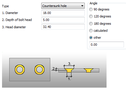

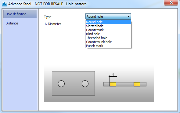

Type
Select the hole type for the selected element. The dialog box displays the parameters for the selected hole type.
Diameter
Defines the hole nominal diameter.
Diameter
Offset
Defines the slot offset.
Length
Defines the length of the slotted hole.
X-axis
Defines the direction of the slotted hole. The slotted hole is rotated by 90°.

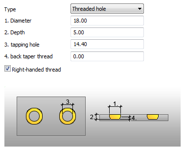

Diameter
Depth
The depth of the hole.
Alpha
Diameter
Depth
Defines the depth of the hole.
Diameter
Defines the punch mark diameter.
