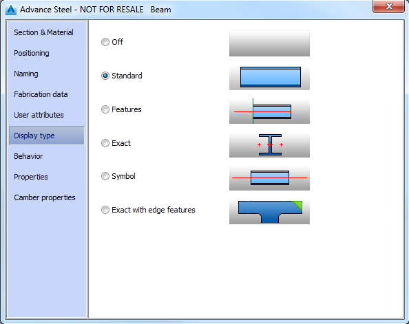

On this tab of the properties dialog box, you can select the beam representation type.
An Advance beam can be displayed in five representation styles:
Display type |
Beam |
Description |
Standard |
Section edges and insertion axes of the beam |
Features |
Section edges and processing objects |
Exact |
Section edges and gauge lines, crosses on end points of the insertion axis and four reference points in the start and end plane |
Symbol |
Insertion axis and a small part of the beam in the center |
Exact with edge features |
Section edges and edge processing objects |
In each representation type, the beam offers different grip points:
Display type |
Beam |
Description |
Standard |
End point insertion axis, reference point in beam center |
Features |
Grip points to change the processing |
Exact |
Reference and corner points of the beam |
Symbol |
See standard representation type |
